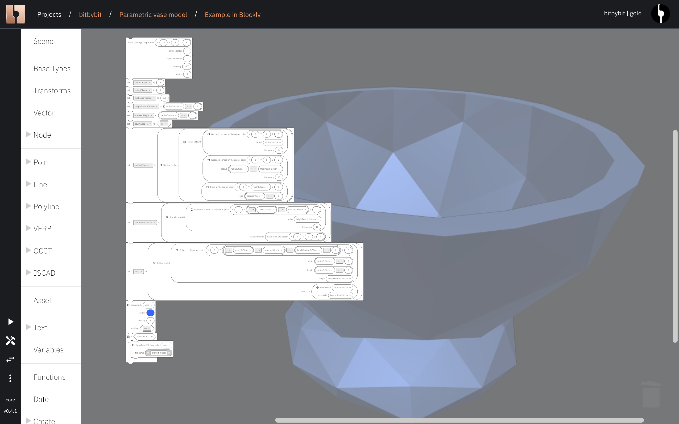

      Bitbybit.dev is web based, runs on a browser and already includes few CAD libraries like JSCAD, Opencascade.js and Verb. While still in active development I've recently updated my app to include latest JSCAD algorithms, made them run on a webworker and introduced some ok'ish caching mechanism that improves development experience throughout separate script runs. All algorithms of JSCAD run asynchronously on a worker, thus UI doesn't freeze while executing.
      Maybe the biggest difference from other editors is that I expose all CAD algorithms through two editors - Visual Programming editor based on Blockly and Monaco editor based on Typescript. Both of these wrap JSCAD through my custom type safe API. This may be interesting if there are people here who work in education. For beginners visual programming may be a bit easier to grasp at first, but even if you're a dev, sometimes it's just faster to sketch some scripts in blocks šŸ˜‰ Also I normalised the API so that all algorithms exposed through visual blocks would also be available in Typescript.
      This allows API docs to look like this (need to update those docs a bit though šŸ™‚

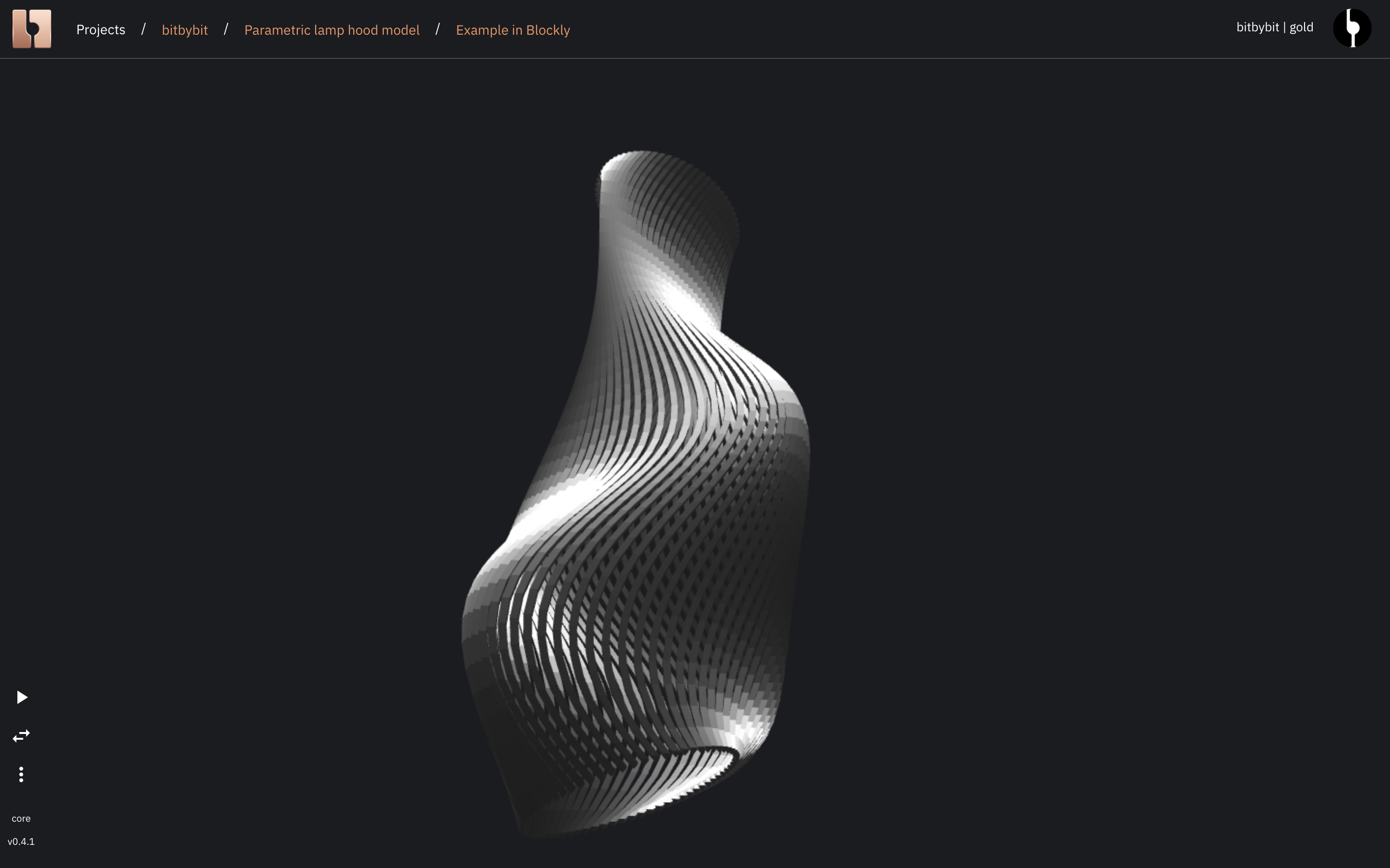

      https://bitbybit.dev/app/bitbybit/YQ0LWrb6gsx3jZqmu5vC/PAkQe6rcHNjznDKbZZWT
      Variant of this script I 3d printed some time ago
