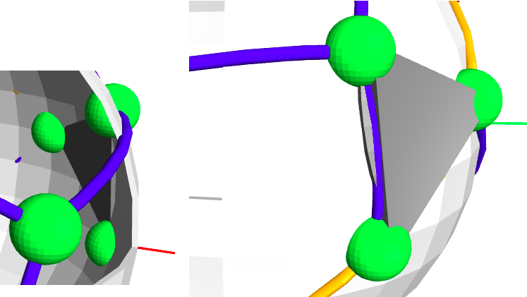

      For drawing a spherical triangle I need to draw 2 "sp_tria2()"s in that triangle on the sphere. "sp_tria2()" might overshoot sphere triangle borders as here:
      https://stamm-wilbrandt.de/en/forum/JSCAD.sp_tria2.png
      Next I create "hull()" from 6 points (found no way to do that, created "hull()" of 6 very small "cube()"s instead), the 3 triangle coordinates, and those coordinates scaled up to that "hull()" completely contains the wanted triangle part of "sp_tria2()":

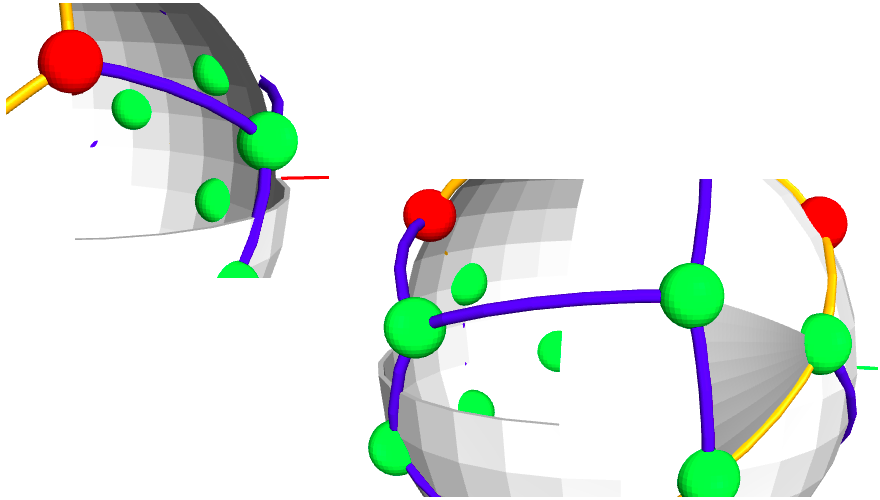

      https://stamm-wilbrandt.de/en/forum/JSCAD.sp_tria.subtract_hull.problem.png
      Here is hull definition:
              h =            hull(
                                 cube({center: sv1, size: 0.01})
                                 ,cube({center: sv2, size: 0.01})
                                 ,cube({center: sv3, size: 0.01})
                                 ,cube({center: s1, size: 0.01})
                                 ,cube({center: s2, size: 0.01})
                                 ,cube({center: s3, size: 0.01})
      Why does "subtract()" not work when subtracting "h"?
      (subtract does work for look_inside=yes, subtracting sphere and cube from outer sphere)

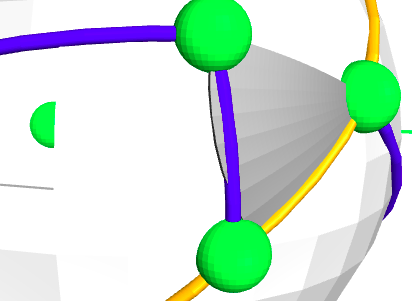

            Oops, too late/early, need to get more sleep.
            1. problem was bad indentation of brackets and placing ",h" at wrong level.
            2. problem was that I want "intersect()" and not "subtract()":
                    return colorize([0.5,0.5,0.5],
                                 intersect(
                                    translate([0,0,0],
                                              rotate([0,0,la1-degToRad(180)],
                                                     rotate([0,ph1-degToRad(90),0],
                                                            rotate([0,0,-al13],
                                                                   sp_tria2(sc, s12, mpi(al13-al12), 0.1, 40, 40)
                                     h
            Works like a charme now:
            https://stamm-wilbrandt.de/en/forum/JSCAD.sp_tria.subtract_hull.solution.png
