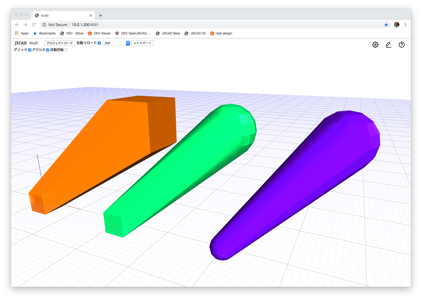

      V2 includes hull for 3D geometries, as well as 2D geometries. This has been long overdue, and one of the most requested features over the past few years.
      Big thanks to @jallwine and @hg42 for the initial V1 versions.
      Example of hull for 3D geometories
      Example of hull_chain for 3D geometries

              Wow! Sorry for the late reply..
              Here's the V2 code that produced those shapes using both hull() and hullChain() functions.
              const {primitives, hulls, color} = require('@jscad/modeling')
              const {translate} = require('@jscad/modeling').transforms
              const main = () => {
                const g1 = primitives.cuboid({size: [4,4,4]})
                const g2 = translate([15, 15, 15], primitives.cuboid({size: [10,10,10]}))
                const g3 = translate([20, 0, 0], primitives.cuboid({size: [4,4,4]}))
                const g4 = translate([35, 15, 15], primitives.ellipsoid({radius: [5,5,5], segments: 16}))
                const g5 = translate([40, 0, 0], primitives.ellipsoid({radius: [2,2,2], segments: 16}))
                const g6 = translate([55, 15, 15], primitives.ellipsoid({radius: [5,5,5], segments: 16}))
                // various hulls between different shapes
                const s1 = hulls.hull(g1, g2)
                color.color([1,0.5,0], s1)
                const s2 = hulls.hull(g3, g4)
                color.color([0,1,0.5], s2)
                const s3 = hulls.hull(g5, g6)
                color.color([0.5,0,1], s3)
                return [s1,s2,s3]
                // example of hullChain between three shapes
                // const s1 = hulls.hullChain(g1,g4,g5)
                // return s1
              module.exports = {main}

                Hi,
                after being offline from JSCAD for some time now, I am slowly trying to get back to a new working environment, now using V2. I know it's not production ready, which doesn't matter for me, it's only an exploration and I also want to help with testing or ideas etc.
                While having several issues currently (mainly understanding how to do things in V2 and current status of the new code), it would probably help (me), if you could post the code you used for these images (or a pointer to it).
