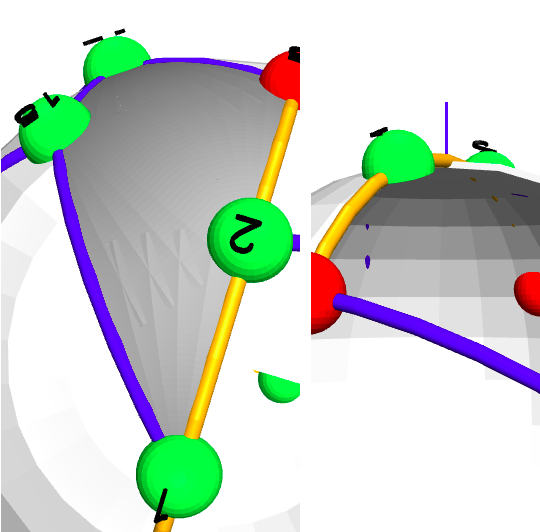

        Added debug feature "look_inside" for the white sphere:
        https://forums.raspberrypi.com/viewtopic.php?p=2028520#p2028520
        alt text
        Learned that number of segments for white sphere is a problem when "subtract()" another sphere with radius reduced by 0.1. 180 segments was no problem for OpenSCAD, for JSCAD I did set parameter default to 30.

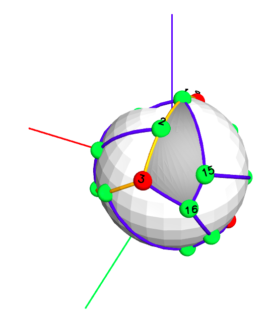

                After a problem with spherical triangle implementation (my problem, not JSCAD problem) ...
                https://openjscad.nodebb.com/topic/378/problem-with-subtract-ing-hull-is-this-a-bug/3?_=1660487451987
                ... now spherical triangle works. I called it three times to fill one spherical pentagon:
                ,sp_tria(2,1,15)
                ,sp_tria(2,15,16)
                ,sp_tria(2,16,3)
                You can see spherical gray polygon from outside, and nothing of spherical polygon breaks into white sphere difference on the inside:
                https://stamm-wilbrandt.de/en/forum/JSCAD.spherical_polygon.js.png
                Click for view+rotate+zoom, design regeneration takes less than 3 seconds on Intel i7 Chrome
                (normally I use chromium-browser on Raspberry Pi OS, will test that in 2 weeks):
                https://www.openjscad.xyz/?uri=https://stamm-wilbrandt.de/en/forum/JSCAD.spherical_polygon.js
                Clicking "Enable Auoto-zoom" and "Enable Auto-rotate" results in nice animation ...

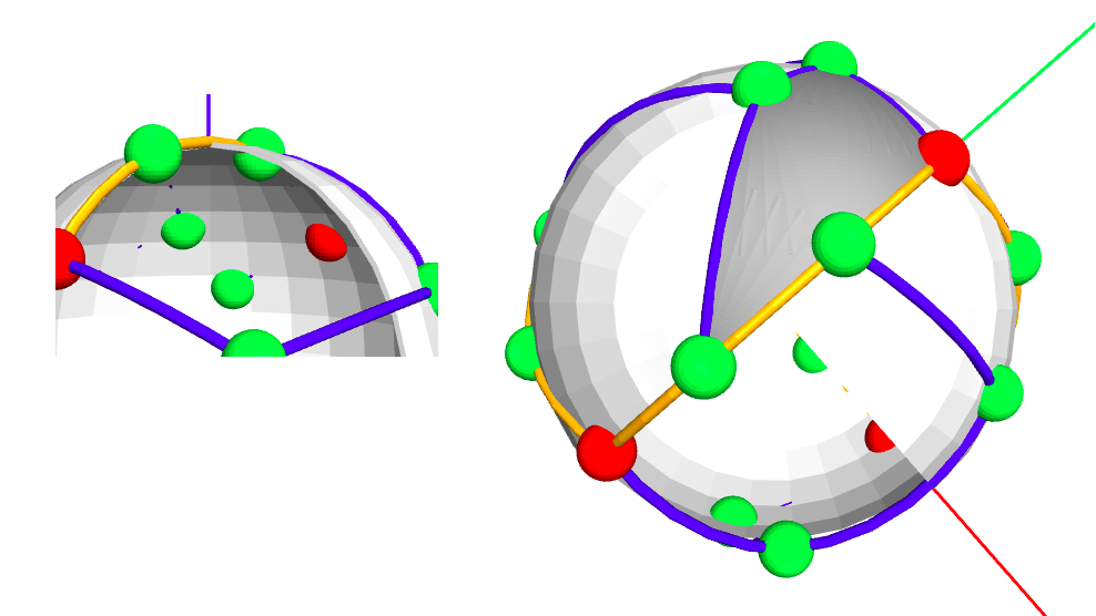

                    Done, now "vertex()" optional 3rd parameter "half" works as well:
                    https://www.openjscad.xyz/?uri=https://stamm-wilbrandt.de/en/forum/JSCAD.vertex_half.js
                    Green vertices 1, 2, 15 and 16 are forced as "half" vertices, that is a cube of right size gets subtracted from inside. Subtraction can be seen for vertex 1 at "look_inside" hole border. Vertex 2, 15 and 16 cannot be seen on inside anymore, unlike the other vertices with default "half=false":
                        vertex(0, [1,0,0])
                        ,vertex(1, [0,1,0], true)
                        ,vertex(2, [0,1,0], true)
                        ,vertex(15, [0,1,0], true)
                        ,vertex(16, [0,1,0], true)
                    https://stamm-wilbrandt.de/en/forum/JSCAD.vertex_half.js.png
