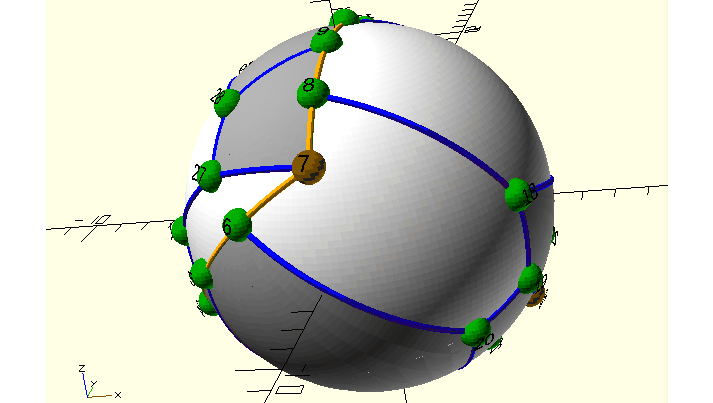

      I have a JSCAD model of C36.10 fullerene graph embedded onto sphere:
      https://openjscad.xyz/?uri=https://stamm-wilbrandt.de/en/forum/C36.10.concave.jscad
      I would like to be able to click on a vertex, and then that vertex should be moved to centroid polar coordinate of its neighbors, like vertex 7 here:
      Since JSCAD is JavaScript in browser, it should be possible to add callback for mouse click event.
      But is there some helper function that tells me which JSCAD object I have clicked on I can use in callback?

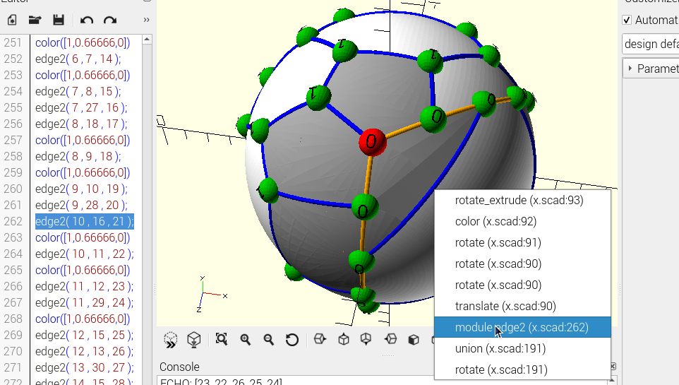

          • Hermann-SW
            Hermann-SW @Hermann-SW last edited by Hermann-SW
            Not exactly what I asked for, but OpenSCAD shows stack trace when right clicking on an object, here for "edge2()":
            https://forums.raspberrypi.com/viewtopic.php?t=333342&start=50#p2022797
            Has JSCAD similar functionality?
            https://stamm-wilbrandt.de/en/forum/OpenSCAD.object.stack_trace.png
            hrgdavor Jason Sprouse 2 Replies Last reply Reply Quote 0
