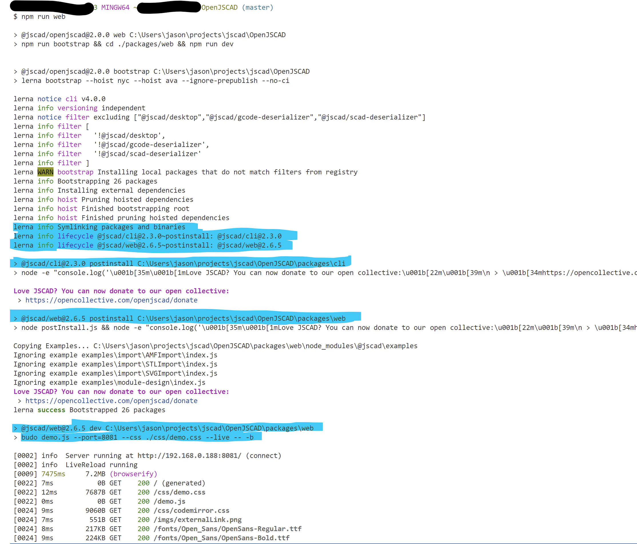

      I posted a prompt suggesting the addition of some generative ai capabilities. In running the app locally I see that it is system linking the @jscad/cli and @jscad/web packages and running the postInstall.js script, but then after successfully bootstrapping it's running this demo.js script.

            @Jason-Sprouse what you installed was the WHOLE project, which requires NODEJS, NPM, etc. you will find the code for the CLI and the WEBUI. Once setup, you can change the code, run tests, add new functionality, etc. The packages are linked together.
            The CLI can be installed directly from NPM. See the README for the CLI.
            https://github.com/jscad/OpenJSCAD.org/tree/master/packages/cli
