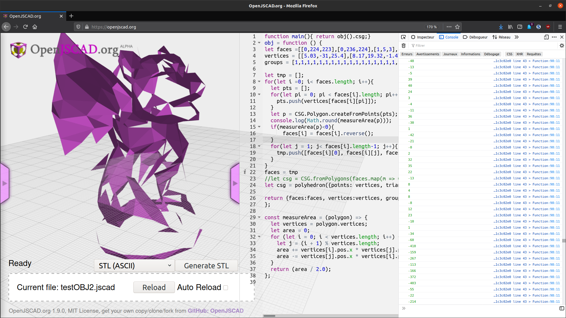

      Hello, as winding reversal for polygons having a negative area works in v2, I tried to do the same on the V1 scripts that I have on my website, but it isn't that easy.
      Capture d’écran de 2020-09-14 15-45-29.png Capture d’écran de 2020-09-14 15-45-51.png
      I have a polyhedron with polygons having positive and negative areas, when reverse negative areas polygons, and display the volume, it has lots of missing faces , and surprisingly if I negate all polygons, it is correctly displayed. Maybe is my measureArea function wrong ? I took if from csg.js and adapt it ( vertices.. [0] changes to vertices... .pos.x and so on). Seems that I'd better start to change my website to V2.
