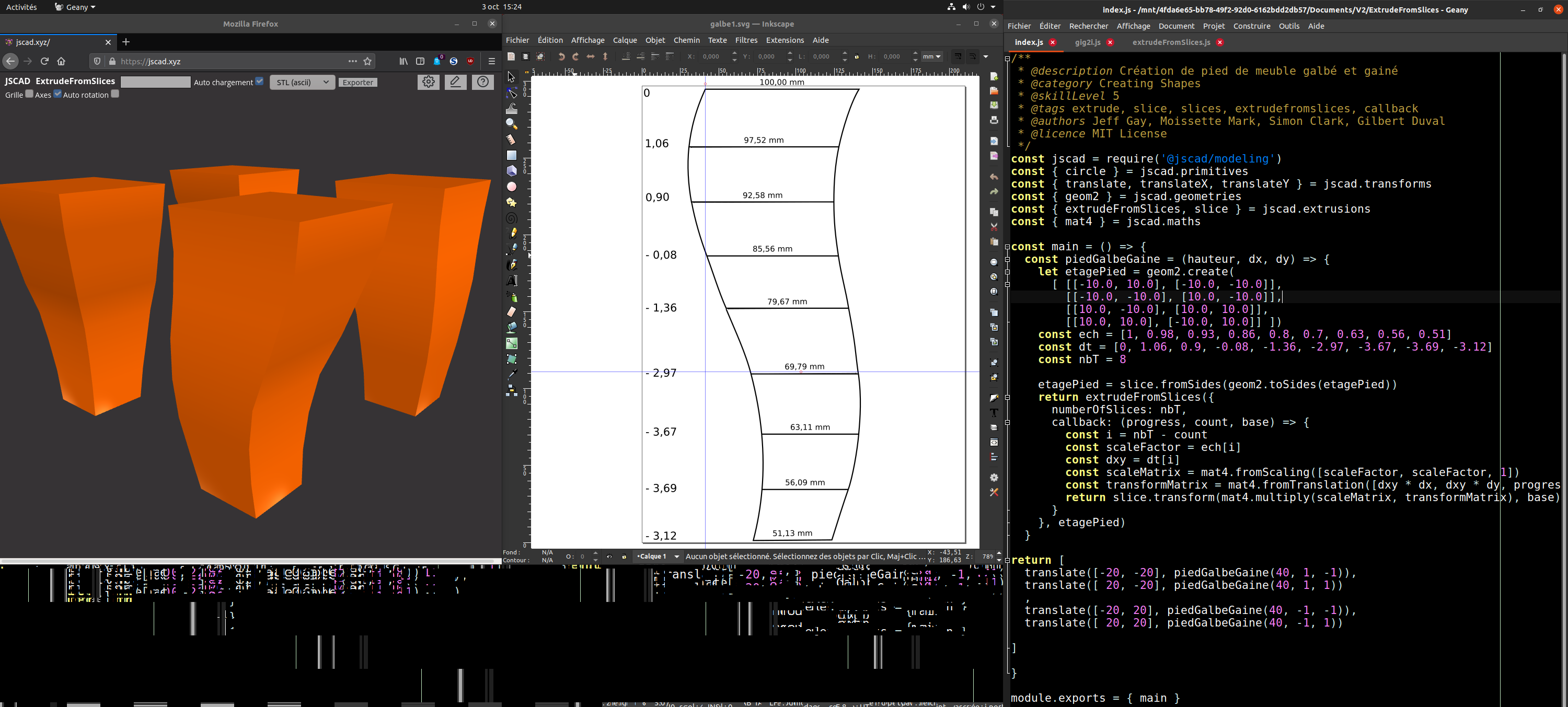

      Thanks to V2 examples, I was able to make a script to create a curved and sheated furniture foot generator. I only need to make it parametrable and it will be done.
      1 Reply Last reply Reply Quote 1
