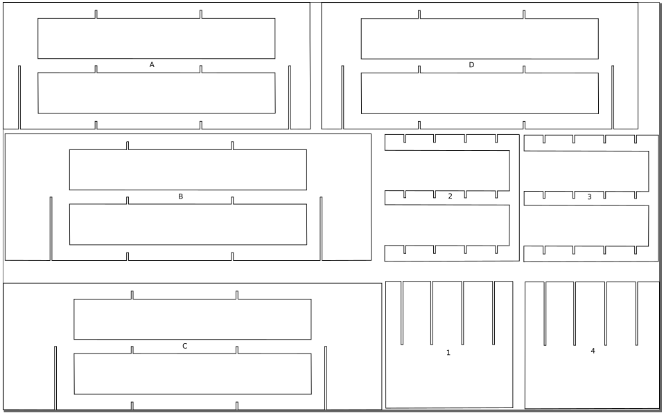

      Hello, I had a 3d model that I wasn't able to export to 2d format after I sliced it on 2 axis , and I just found that there were extraneous lines on it that needed to be removed.
      After I removed red lines (on the left model), I was able to slice it and export resulting slices to 2d (svg).
      now when I encounter this export error, I will look for lines that can be removed, but I suppose that a solid projection function could work even with them. Does anyone know how I could do to make a real projection function ?

        @z3dev I'm currently working with furniture models, they are all hand made. I sliced 8 models (they are available here https://github.com/gilboonet/designs/blob/master/MEUBLES/readme.md, each picture open the corresp. model into jscad) and they are clean because my scripts (slicer and unflattener) can only produce patterns for models without errors (holes, non-manifold). It's certainly my process that met an unhandled condition. To produce 2 axes imbricated crosspieces, I need to slice and then split slices that are made of multiple separated pieces because crosspiece cut need to be done for each piece. As you said it is too complex to debug. I need to simplify my process, maybe voxelization could help.

            @z3dev It made the slices, but the error happened when exporting to 2d. At first, as it is a very large model (120 cm x 40 x 40) I try to halve it but it still didn't export. I didn't test deep enough to know what exactly is causing this but when choosing slices position, some cause errors on the top of other slices. The script with erroneous 3d model is here https://jscad.xyz#https://raw.githubusercontent.com/gilboonet/designs/master/MEUBLES/sq_ed0008_err.js.
