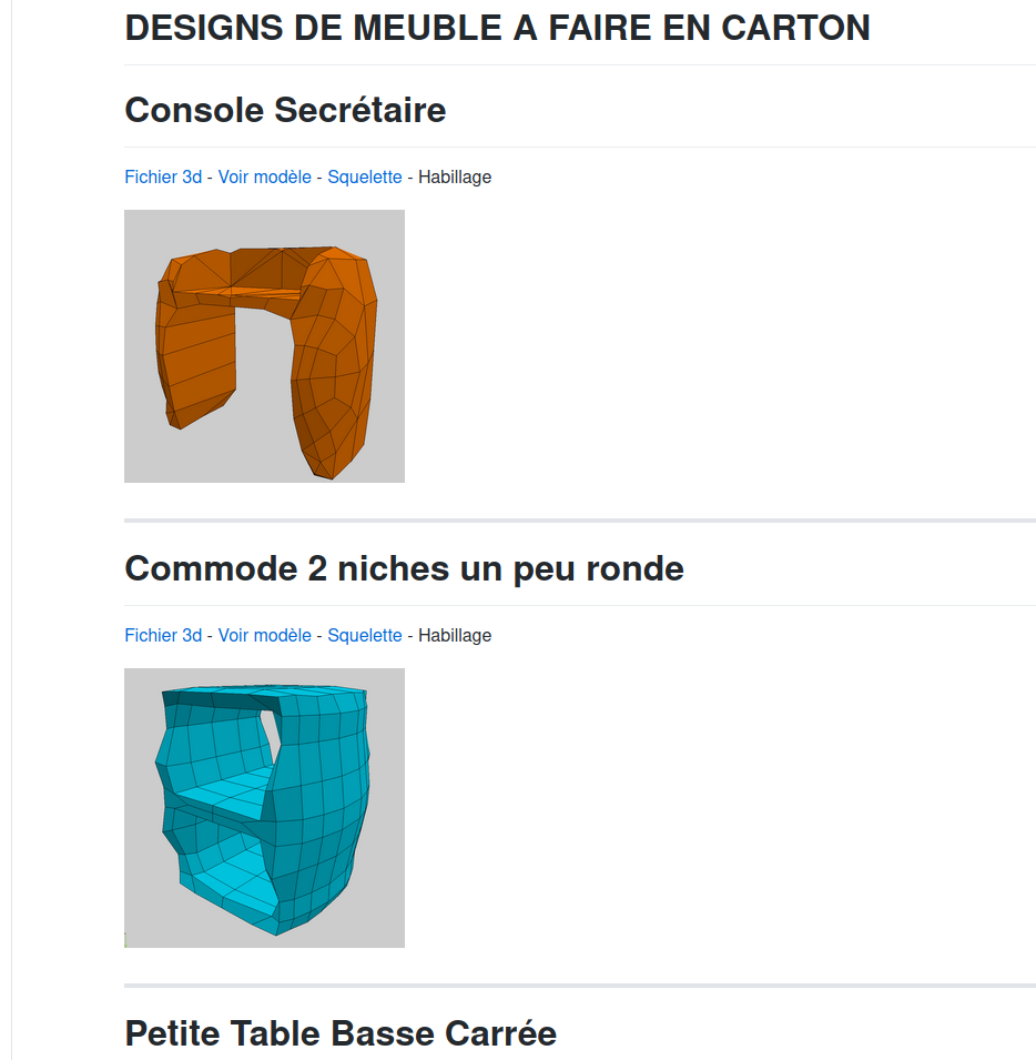

      Hello, I'm deploying crafting resources on design section of my github account, and to do so I share several furniture designs, I have about 10 now, but I have lots more to add. For each of them I share the 3d model and links to open jscad scripts with them. I currently have almost the same using v1 and I wrote an html/js page to create jscad code with the good script and the good 3d model. I don't know how to do that with v2, so I'm trying something else.
      ( can be seen here : https://github.com/gilboonet/designs/blob/master/MEUBLES/readme.md )
      For each design there's :
      • direct link to the 3d model ("Fichier 3d" link)
      • link to view the 3d model with online 3d viewer ("Voir modèle" link)
      • link to my jscad script for skeleton 2 axis slicing with the 3d model
      • (and to come link to my html/js unflatten application)
      I would like to replace the link to online 3d viewer by a link to a jscad script where it would be possible to rescale it, and show its dimensions, but the only solution that I have in mind is to write a script for that, and duplicate it for each 3d model. It's already what I am doing for the skeleton script.
      Do you think that for such case, I mean choose a model then a script to apply on it, there could be a mechanism. Locally I already use dynamic require from a text parameter and it works well, but on remote script I didn't manage to make it work. Maybe is there a way to run a script from a remote folder ? or a way to require an url ?
