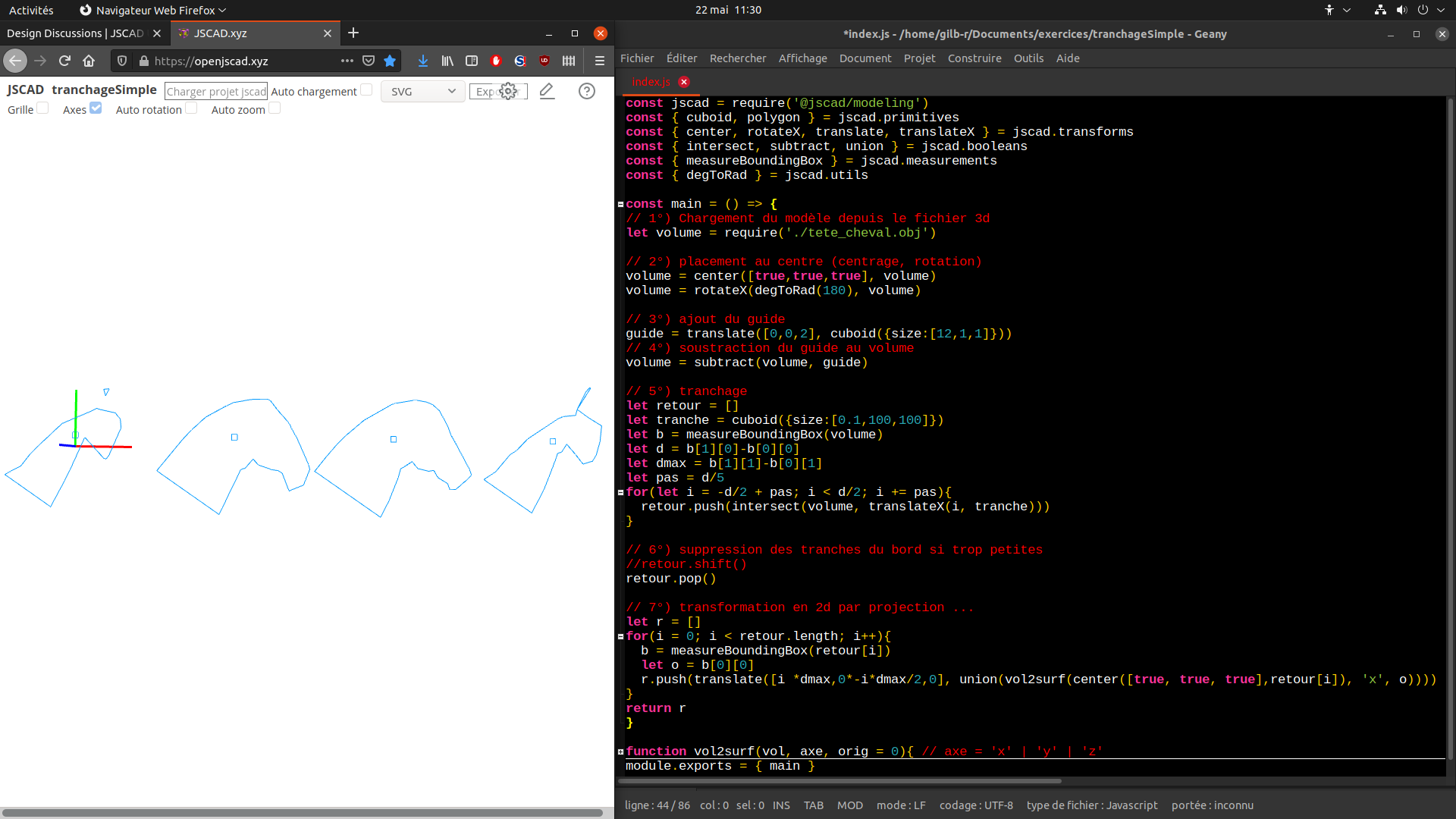

      Here is the basic design where it would be useful to use a projection function. In order to make simple scroll saw pattern, I was asked to make a generic script that users could easily change. For the moment it's using my function vol2surf that "works" as a projection even if it far from that.
      I saw that a projection function is now available (projectionOfPoint), how can I use it to replace mine ?

          Here's a first test :
          The output is the same as it was with my function.
